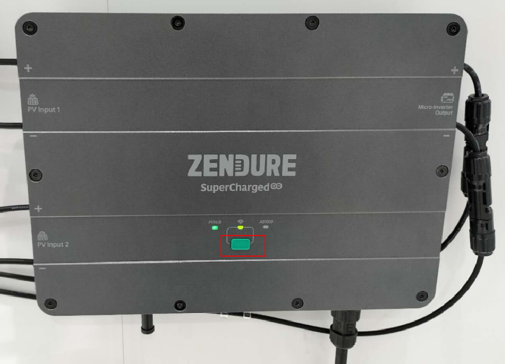

If the Wi-Fi indicator is not blinking, press and hold the IOT button for 3 seconds to begin Wi-Fi configuration.
If the Wi-Fi indicator still does not turn on or blink, press and hold the IOT button for 6 seconds to turn off the Hub. Wait 10 seconds, then press and hold again to turn it back on.
