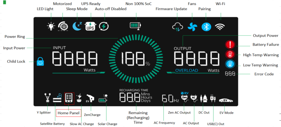

If the Home Panel is currently receiving power from the grid, you can activate off-grid mode by pressing and holding the AC button on your SBV until you hear three beeps. When you release the button, the Home Panel icon will appear on your SuperBase V’s display in the lower left section. At this point, you can either shut down the breaker or use the Zendure app to activate off-grid mode.
