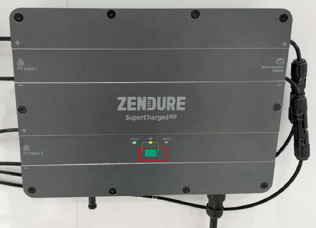

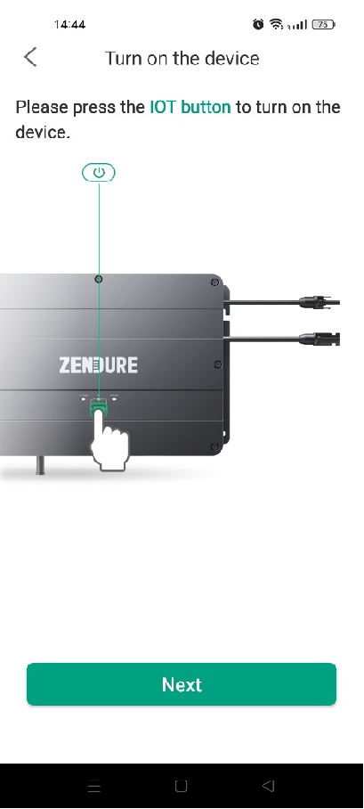

1. Activate SolarFlow according to instructions.

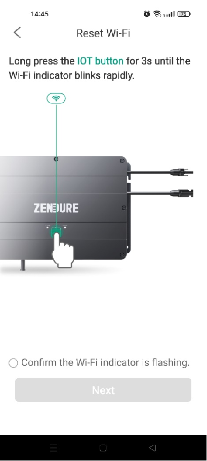

2. Please hold the IOT button until you hear two beeps and the Wi-Fi indicator starts blinking. Then use the Zendure App to finish connecting SolarFlow to your Wi-Fi network.

      If the Wi-Fi indicator is not blinking, press and hold the IOT button for 3 seconds to begin Wi-Fi configuration. If the Wi-Fi indicator still does not turn on or blink, press and hold the IOT button for 6 seconds to turn off the Hub. Wait 10 ...
